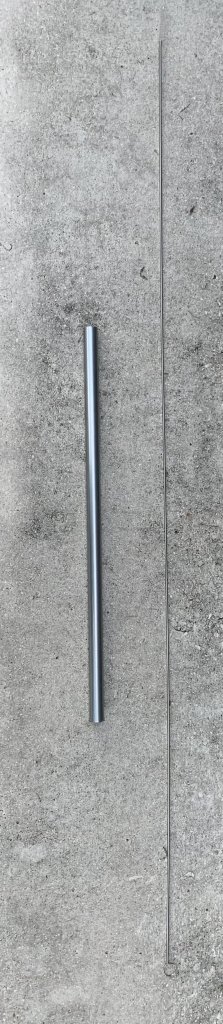

- A galvanized pipe (2ft lenght x 1/2 inch or 3/4 inch diameter)

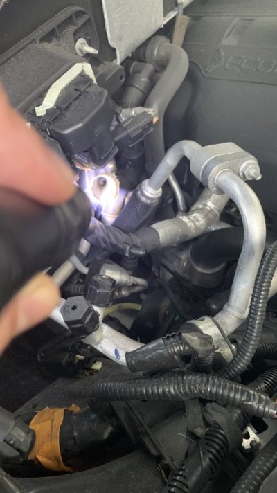

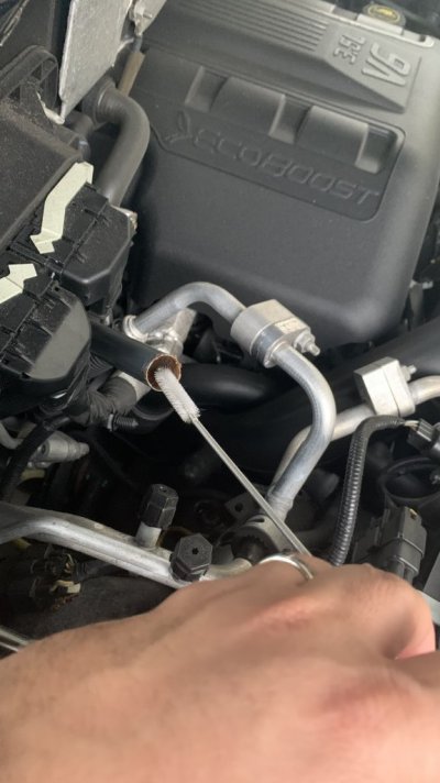

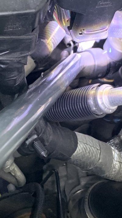

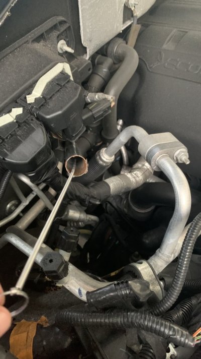

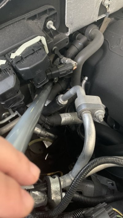

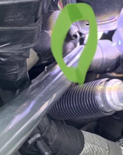

1. Have a visual of the drain pipe.
2. Get the galvanized pipe and align it to the drain pipe (no need to push or wiggle anything around). Don’t push.
3. After the pipe in position, its very easy a nd straightforward, let the drain brush through. Very simple. Be gentle and do not Push. Remember you dont want to damage the coil inside, let it all through, if anything was obstructing it will be pulled out with the brush.
I am sharing some images depicting same steps above.
Hope this helps you!
