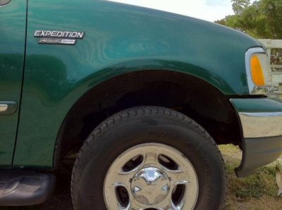

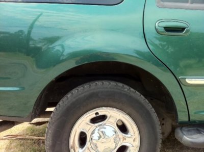

A few leveling questions

panda24619
May 18, 2010
5,501
42
San Diego
so what do you have now? air? then convert it first with this. crank your t bars and add a 2" spacer. itll level it, if its already lifted then just see if you can crank anymore and get a 3" spacer. then you can fit 305s no problem, but you can even fit 315s.
Would 305s fit with a 2" rear spacer? What about wheel spacers?

youll fit no problem. on stock rims!!! other wise you can get 8" wide with a 4.5" backspacing. any wider or different backspacing youll rub somewhere. and need to trim or get wheel spacers. so no need for wheel spacers and you can fit 305s. itll be about 33-34 depending on the tire. 315s are about 34-35. remember that 305 is the width and the next number is the percentage of the width on the sidewall and 3rd number is the rim. use this so you dont get confused. http://www.redrock4x4.com/tireconve...txtWidth=&stxtRim=&submitButtonName=Calculate

Okay thanks, I was going to add spacers only to give my expy a wider look. That wont put too much wear on my front and rear end will it? Im going to stick with my stock rims for now

it shouldnt. i mean anything will, but if your going to do spacers dont go off any big jumps! haha but also you might have some rubbing issues. you will if you do 315s, but with 305s you might have to trim the plastic pieces a little bit. not much.
