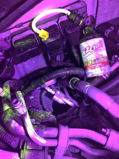

TLDR: 33oz Capacity. Filled approx 22oz. Has Aux AC in Rear. High 200 Low 45 so I stopped filling. Filling took a very long time. AC is cool not cold. $150k miles. Clogged Condenser, Expansion? Is the Rear AC tied to the front or can I check the rear somehow too... Thanks!!!
Only filled about 22oz including the pos Walmart UV can which sprayed dye all over and over can of AC Pro High Mileage 12oz.
Compressor and clutch are engaging. There is an oil leak from PS that sprayed everywhere so I removed clutch to check and it was intact just cleaned it up.
Checked for leaks via Vacuum pump and vape to see if it may suck any up and didn't discover anything running the top lines and under the compressor.
When it is off they balance out so 110psi on Low and High (See Second Gauge Pic). This is how it's supposed to be; correct?
