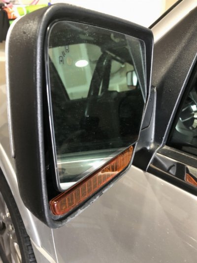

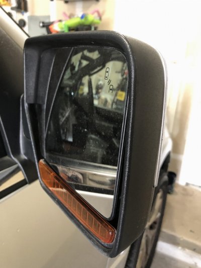

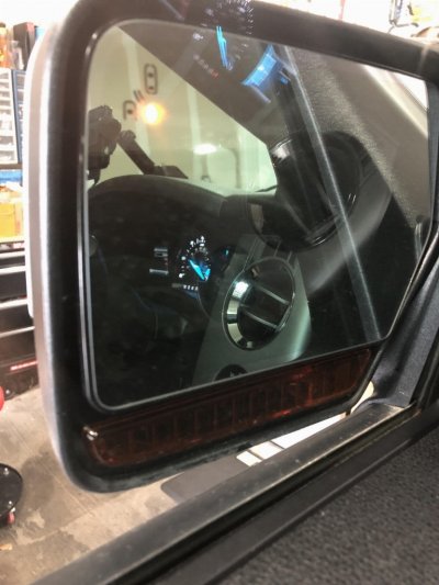

The BLIS mirror glass is different from the blind spot mirrors so no you can't have both. BLIS was a standalone option even on XLT but required the 202A package. That means it came on mirrors that were power with memory and had heated glass and integrated turn signals.
On 2015-17 Limited models, you get power memory, heated, auto-dim, turn-signal and power-folding mirrors with blind spot glass as standard. Adding BLIS, though, deletes the blind spot glass as far as I know.
2015-17 King Ranch and Platinum models had BLIS as standard equipment.
