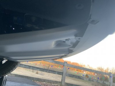

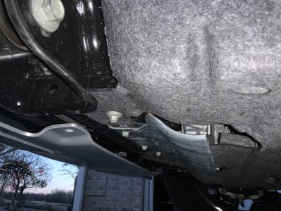

Here’s a few photos. It appears to be ‘flatter’ than the raptor mounting position, as the rear mounting holes are slanted towards the front. Tightening the front bolts down seems to tilt the back down, but doesn’t make the mounting tabs level.
I used the standard raptor front mounting brackets for the front.
the bottom of the bumper needs the rearward facing tabs trimming off to make it cleaner ( the skid plate it slightly touching the lower part of the bumper).
looking at it, again, a piece of 1” angle with tabs welded on for the bolts that hold the front of that felt cover (transmission cover? Front diff cover?) would hold it. I can’t think that there would be a standard piece which fits - especially reading how some of the F150 guys have had trouble.
