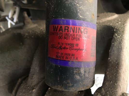

How do I determine whether or not I have the air ride vs standard suspension?
Are there easily identifiable parts I can recognize to establish which one the vehicle has?

take some pics of behind any wheel, better yet take pics with the wheel off and post it.

You can see the airbags just by looking at the suspension where the shocks would be. If you see coils, you dont have airbags. The 2nd generation actually makes it easier to tell from the 1st or 3rd gens.

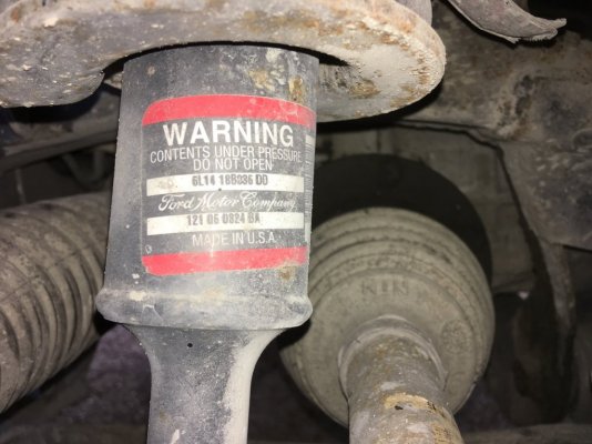

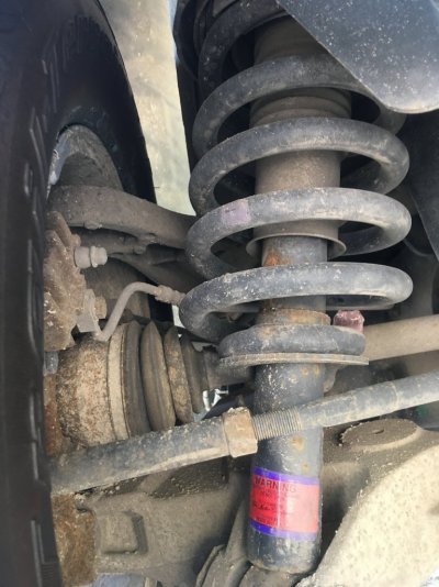

Thank you Yupster Dog and dlcorbett. Appreciate the input.
Here are some photos I took.
Sounds like I have the standard suspension.

Yea std springs. The air springs changes the ride to luxury car levels. The Navigators on air springs ride so much smoother than the expy on coils.
