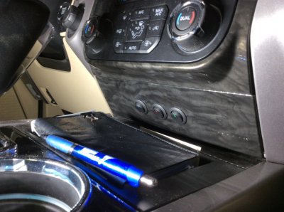

I would’ve loved to have a Raptor style switch panel , but couldn’t figure out where to put one and make it look good , so this is what I came up with, they’re out of the way, not real noticeable,
