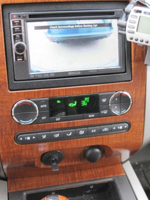

I also have a Kenwood head unit in my 2008.

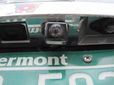

For the backup camera, I have a switch on the dash (in the OEM Aux in location) that turns the camera on, and changes the display to the rear camera. I just followed the video line with a small gauge wire to power the camera.
This way I can turn the camera on and check my trailer when I'm towing. I mounted the camera just above the license plate in the chrome bezel. The camera is not a flush mount camera.

Pictures of my camera, switch location, and the head unit showing the camera's image.
Sorry for the dirty truck, but we just had a brief snowfall and the raods were recently salted.

why the need for a switch? it should come on automatically when in reverse from you lights unless you wanted a anytime switch?
Canadian Expy
Jul 16, 2010
3,039
154
Toronto ON
I put mine on switch, there a times when a switched it on , when not backing up. Like checking the trailer when towing,
