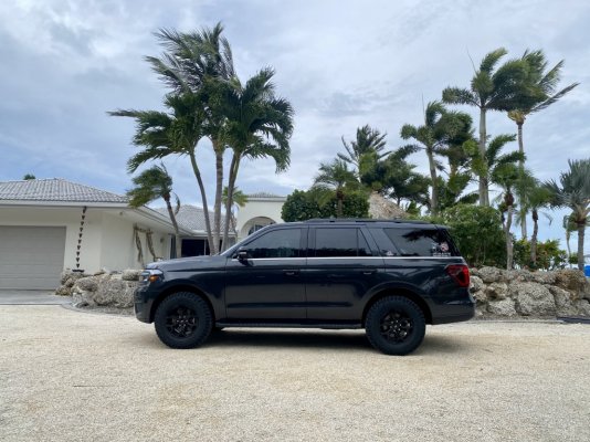

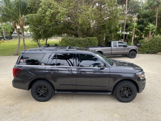

I have been running Nitto Recon Grappler 295/70/18 with OEM wheels with no issues. I also have a Raptor and the Expy is no Raptor but its really quite capable for a big SUV - the rear elsd is not going to be as stout as the Raptor. It really depends on what your intended use is...
I'm curious - Is there a vehicle inspection in Norway which would expose a non TUV approved lift?

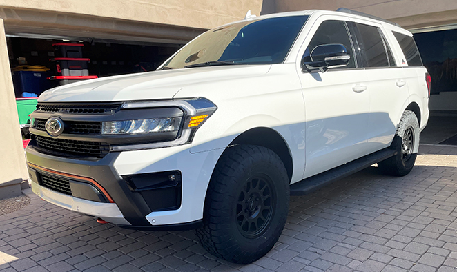

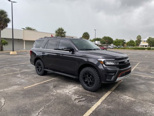

My issue with 295/70/18 is the height
Its 34.26" or 870mm and I felt it was a little too snug in there.
I want something around 33.8 or 858 mm.
I spent 5 months with all kinds of tire sizes and combos, spread sheets to find the right size for stock timberline.
Issue is when you mix the width and rim size the height is all over the place.
For example
I wanted 17" rims
so a 295 width at 70 would put me at 33.26 height. To small.
and a 285 with at 75 would put me at 33.83 (good height) but be only 3/4" wider than stock.
I went with 305/70/17 which is a great height and the 305 with 12" wide and with +25 offset they do not stick out or rub.
My Timberline looks like a Artic explorer. Would look a tad better with a 1" lift, but that would be cosmetic only as the tires fit and ride perfect with no rub, no poke, etc. So a lift would be a waste and add nothing but looks with the setup I have.
