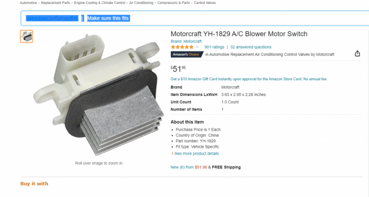

I had a similar issue with my wife‘s 2013. Her Expy has the auto climate controls. I ordered an aftermarket part from Amazon and installed it but had problem. I replaced the resistor with a genuine ford part and corrected the problem. i read somewhere that the controller doesn’t like the aftermarket parts for some reason.

Thank you. Both controllers were Motorcraft. I had heard the same thing with the aftermarket parts. The wiring harness was Duralast, but seemed that is pretty simple and shouldn't be an issue. I did test the resistance through each wire and it was basically 0 ohms.

Just making sure we are talking about the same thing, relay or switch. This is the part I replaced on my '13 expy.

Yes, It was made by duralast, and I got it from Autozone, but that is the part.
I also replaced YH1829. That was the same one I purchased originally on Amazon. The one I replaced this 2nd time was YH2060 Motorcraft from OReiley's but it says that it is a compatible part in a few places I have looked. However the old YH1829 and new YH2060 made no difference in the speed control issue.
