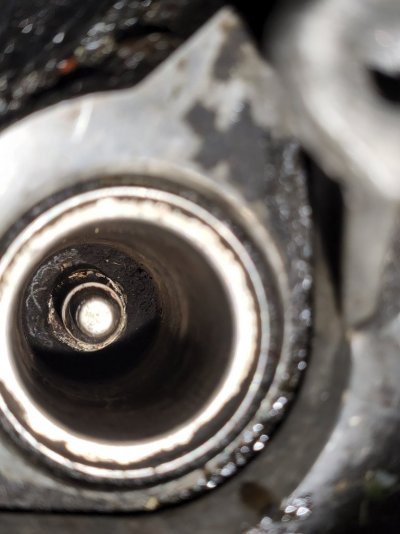

Hi I have a 05 ford expedition 5.4 3v triton, spark plug in number four is broken as in not half due to some sticking out, my original problem was the hex was round but then I went down to a 14 so I could tap it on but it just spins also and once I cleaned it out I see that the hex is ate up some and looks like spark plug is broke I will attach pic any advise would be helpful and totally appreciated

That looks like there is a bunch of greasy dirt packed down in the bottom.
May be keeping the socket from getting around the hex.
Take a pick or skinny screw driver and see if you can clean it up.
Mat also spray some solvent down there to loosen it up.
Blow it out with compressed air.
