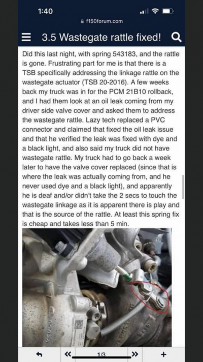

Does anybody have a picture or instructions that could lead me to the wastegate actuator? I'd like to try this.
Here's a video showing the part of the turbo that causes the rattle.
Here's a video showing where it is on the vehicle.
