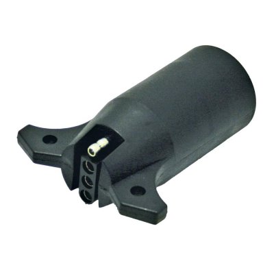

I don't believe that adapter will trick the truck since it runs through just the 4 pin connector. Only the 7 pin connector tells the truck you have a trailer hitched up.
