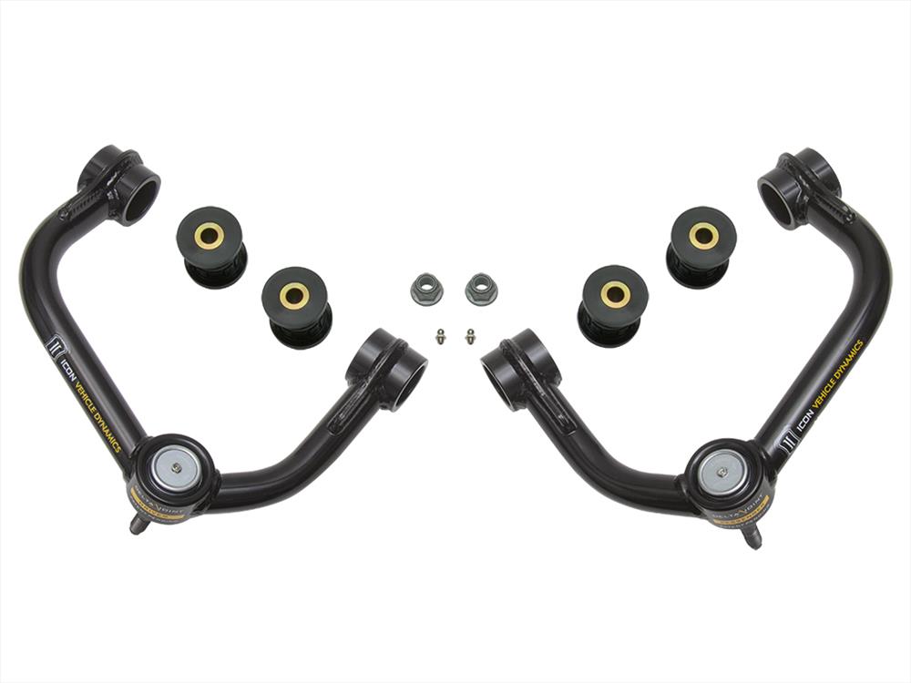

Thanks, Just wondering if there are any typical issues associated with my upgrade. I've seen for instance that the ICON lift can come with control arms. I realize that is apples and oranges with the lift kit I used, but is the control arm upgrade still recommended or required for any lift?. I will look further.
