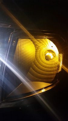

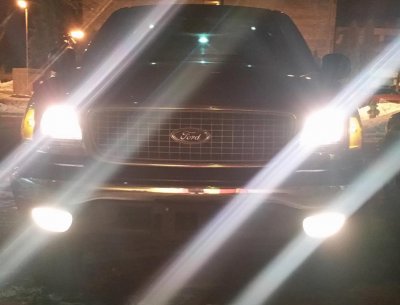

I just finished doing all my outside lights.

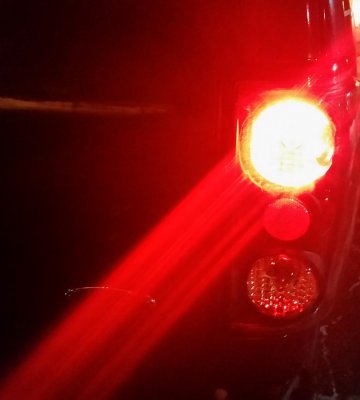

  • Heres the tail lights I got, also from eBay… I had the same feelings about these as I did the headlights, but all in all I am happy. The socket did not sit as tight as I wanted, but I fixed it with new rubber O rings. I am not sure if the issue was with the assemblies, or my sockets. Pics at bottom
I ended up getting the front blinkers and rear blinkers / brake lights from Autozone for $19.99 a pair... I was impatient. I should have just gotten them from eBay, but I did not want to wait. Plus when I installed the clear tail light assemblies, a clear bulb ‘clearly’ won’t work for brake lights. Pics at bottom But they are 3157's. 3157Amber and 3157Red.
They are bright enough without being insane... If you want to go brighter, you can get more SMD's in them. But for me, this is perfect! I would recommend making sure you get bulbs with SMD’s on the side as it illuminates more of the assemblies. It also gives you a nice glow at night. Pics at bottom
On this Wiki page is info on SMD LED's and a chart that shows how bright they come. It may come in handy...
For the high mount brake light, I used 3 of the T10/168/192 LED lights. These bulbs are extremely bright, at least while in a clear housing. Maybe I need to get red ones. I honestly do not notice a difference in brightness compared to a regular bulb in the high mount light. In the end, I would like to replace the entire high mount assembly with a new, aftermarket LED one... But for some reason they are very expensive. Almost 2-3 times higher than a set of tail lights. :confused:
Of course putting in the LED's make your blinkers blink fast... I could not find a relay when I did it, so I just got 4 resistors to install on all 4 lights.. I have not received them yet, so I am dealing with looking extremely stupid with fast blinking lights. But I am going to look into that relay, since that is much easier then splicing into all the wires!
