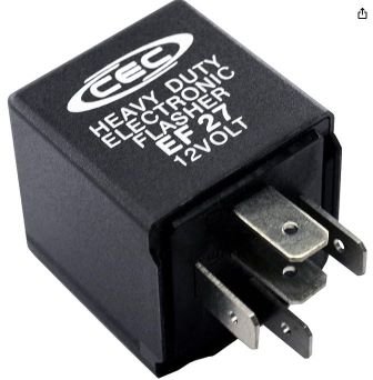

Well, the turn signal issue returned, so I was forced to take action. I purchased this relay from Amazon:
CEC Industries EF27 12V Heavy Duty 5-Pin Electronic Flasher Relay for Incandescent Bulbs (1-Pack)
The reason I bought this one over the many others available is because multiple Amazon Reviewers specifically stated that they had success with this relay in their 2003 Ford Expedition that had incandescent turn signal and brake light bulbs AND was for the model of Expedition that does not have side mirror signal indicators. So, they confirmed that this relay was used with success in a 2003 Expedition setup the same as mine.

I did test the new relay by turning on the Expedition and trying various combinations of turn signals, brakes and emergency flashers. All worked well. However, I would have to say that the relay I just installed is quieter than the original blue Ford relay I removed.
