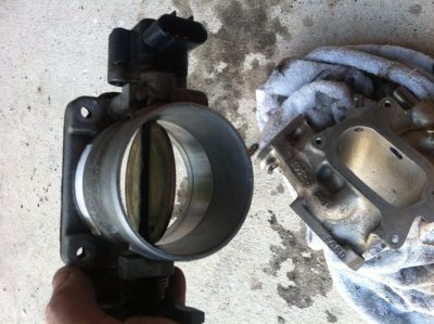

Well came home early to replace egr valve. And it did go quite as I expected. Bolt broke off in intake plentum as I removed it. Had trouble getting access to use an extractor and broke one off, so I took entire plentum off and tried that way and another extractor broke. So I ended up having to drill and re-tap it.
I figured while I had plentum and throttle body off I would clean them up.
Now hopefully this fixes the dtc code and mabe she will even run a little better. :)

Plentum,
Sorry for separate post for pics my phone won't let me do more than one at a time or mabe I just don't know how too.

Bummer on that , upon re-assmlby I would use some anti-seize compound , glad you got it fixed .
BANGEREXPO76
Jan 18, 2013
105
PLUGZONE 76
Sorry to hear about the big mess but once you clean those EGR channels and put it back together your going to be a happy Expy owner.
