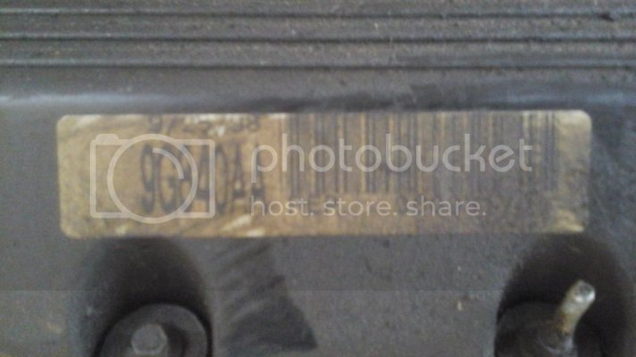

I'm getting mixed results on that. The motor is out of a 1999 F150. Now some say no they didn't get the PI heads and intake until 2001. Others say it was late model 1998 builds and on that got it. Then others say yes all 1999 F150's have it. I'm going to check the heads and see if its written on them . PI heads have "PI" cast into them over the front exhaust port. So I will see. Either way its better than a motor running on 7 1/2 cylinders. Plus it only cost me $500 for a complete running motor with a 30 day warranty.

You just need to look at the intake ports. The PI ports are noticeably bigger and shaped different than NPI intake ports.

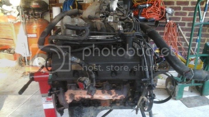

It's a 1998 motor and a NPI. So I'm a little sad. But it's not going backwards it's just staying even. Here are some pictures of the motor.

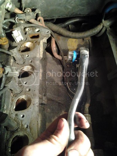

Tonight I pulled the intake, water pump, fuel rail and injectors. Cleaned out the valley under the intake. Pulled my expy into the car port and pulled the hood, intake tube and front cover. Tomorrow will be draining the fluids, pulling the intake on the old motor and breaking loose bolts.
