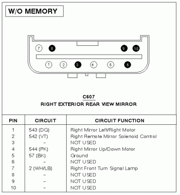

My 99 EB doesn't have heated mirrors. Anyone know if they are already wired for heated mirrors, and only need to make an upgrade to heated?

If you have a test light you can compare the wires coming out of the door connection to the wires going to the mirror. with the key on engine off if you have an extra wire you can probe it with a test light and press the rear defrost button, if the light comes on/goes off when you turn on/off the rear defrost, then you have prewiring for the mirror. source: 2003 taurus I had had the wires

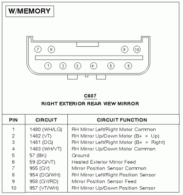

I have attached the connector pin layout for the passenger side mirror's
You will need to remove the door panel to check the connector
One is with memory mirror's
One is with out memory mirror's

Thanks! Had a line on Navi mirrors a while back that fell through. Started looking on ebay, to see what I could find. I'll pull the panel this weekend.

I went through this same issue helping a friend replace a mirror on his 98. Problem is the wiring on a non heated vs heated was a big difference in wires. It can be done, buts it's not plug and play. The non heated plugs don't have the extra wires supplied to the plug, so you have add the appropriate wires going all the way back. Unless your real good with wiring, I'd say leave it be, and hit it with either a little shaving cream, or fog free, available from motorcycle shops. Sometimes it's best not to reinvent the wheel. Just my 2 cents.
1955moose
Nov 23, 2014
5,981
1,338
Forgot to mention in my last post, the plugs are totally different between heated and not heated, so your not only running wires, but adding wires with pins. Not a walk in the park. Again it can be done, but it's got to be worth it in the long run.
