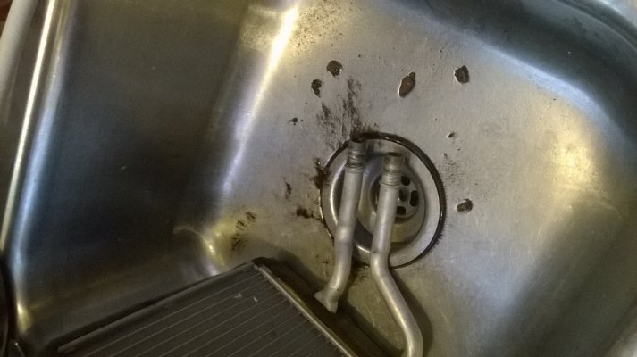

IMINYOURCHAIR
Nov 17, 2013
926
64
Altoona Alabama
I will just leave this here, just because it's not coming out, doesn't mean it's not clogged. I had flushed this core before and it came out clear when I was done, it eventually started leaking so I replaced it. this is just pumping some water through it, much more came out but not as fast as I kept reversing the flow back and forth... I also had cooler heat in the front than I had at the rearEONurbn.jpg

Thanks for the input, I really flushed it good, reversing the flow and dumping it hard etc. I still haven't put it back together but I'm really hoping that this fixes it, the return line was child and I could tell that no coolant was in it when I was checking things out but the inlet line was super hot all the way to the heater core.
