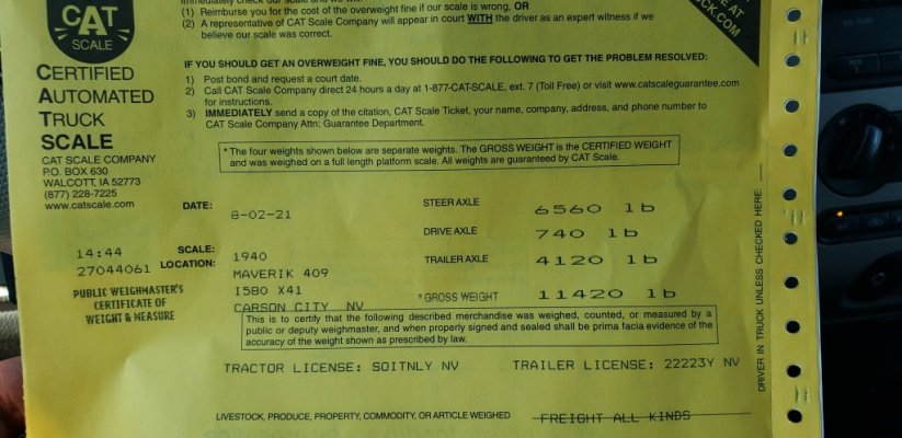

When you go to the scales there will be about 4 huge individual scales. You're going to want to place each axle on a scale. What i did was a little different as it was my first time.
Please reference my pics:
In 'Car Only' pic I parked each axle on an individual scale and what you see is each axle's weight.
In 'GCVWR' I unhitched the trailer and placed the trailer axle on one scale, the tongue on another and parked my entire car on another scale.
My car's tow capacity is a little over 9000lb, hitch weight 750 direct and 950 WDH, 15,000lb GCVWR
So as you can see I technically could tow without a WDH, but it would be unsafe as the tongue weight fluctuates with uneven roads.
My trailer weight is at ~55% capacity. ((4120+740)÷9000)x100
The Gross combined vehicle weight rating is 11420 ÷ 15000 x 100 = 76%
