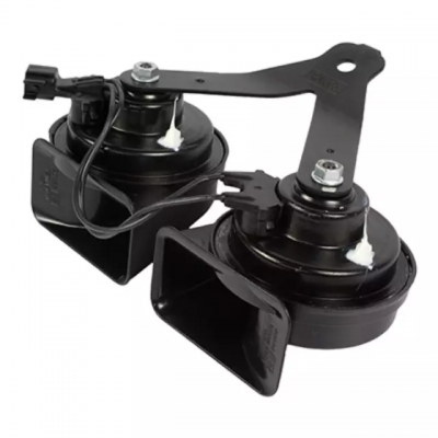

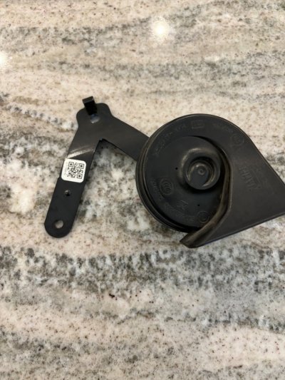

I just got around to fixing the horn(s) on my 2019. Only recently paid attention to the tinny sound so I bought a replacement
FL3Z-13832-B...Following a YouTube tutorial to replace horn w/o removing bumper cover or grill, we (blindly) maneuvered the old horn out and found that it was never a two note horn from the get-go. Examining the horn we removed, there were no signs that a second horn was ever included, no scratches where it would have bolted onto the second wing, and no broken wires. Thanks Ford!
So there is only 1 horn?

The jpg is the actual horn we took out. The replacement had a second horn on the empty wing and no secondary wires to a low-tone horn as shown above
