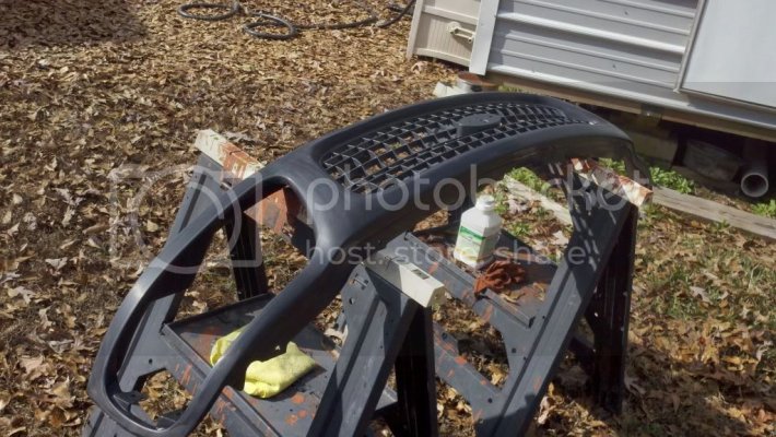

1st i got a paintable grill that fit my year model truck off ebay for around 80.00 with free shipping lol

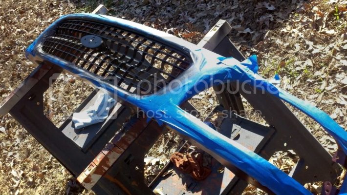

2nd I sanded it with 1000 grit sandpaper, then wiped it down with mineral spirits

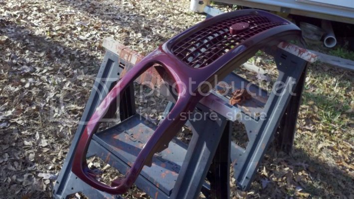

Next i used color matching duplicolor paint and duplicolor clear coat in the can. 2 coats of paint and 3 coats of clear= the cans are small
Next I taped off the outer surround then painted the center satin black

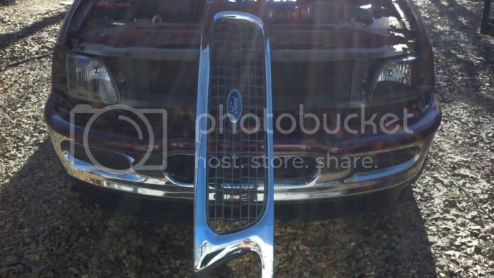

Next I removed the stock grill chrome/bling bling

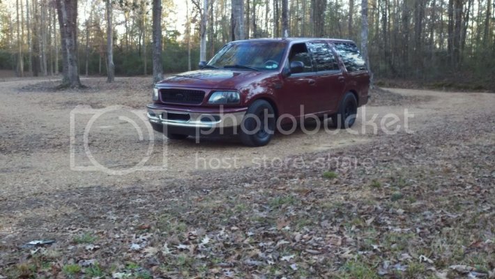

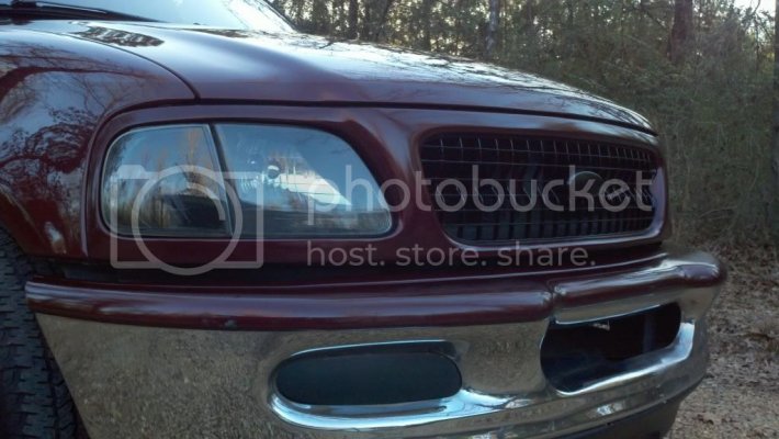

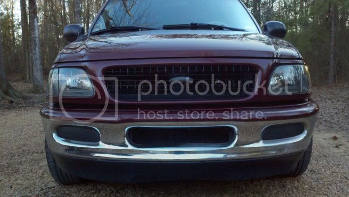

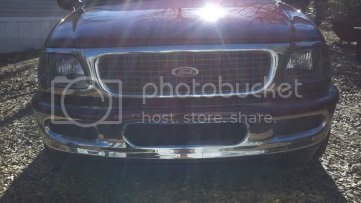

Before=

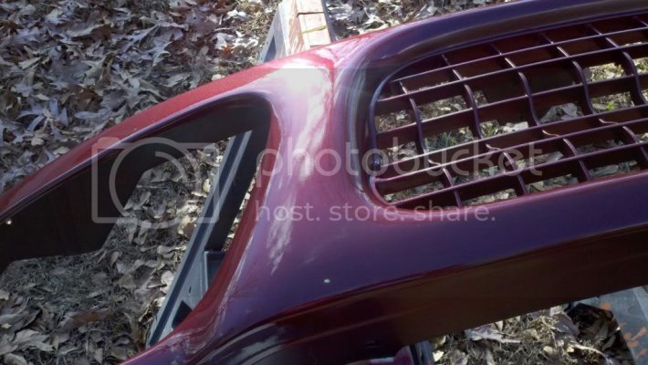

After=

Trey= color code is on the driver door and they have the color you are looking for on the cans with the color code on the cap at autozone, 1 can of paint did 2 coats and 1 1/2 cand of clear did 3 coats, then the next day i waxed it with my favorite wax = p21s.
