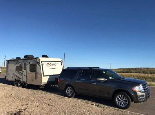

Another data point. We’ve been towing a 5300lb trailer for about 13,000 miles this year alone. We’ve towed in a lot of different conditions from flat hwy to curvy side roads in rain, high winds, and up and down mountain passes. Currently we are in Northern Cal headed to Portland. First, I can tell you without a doubt a sway control/WDH is a must. I can tow comfortably at 75 mph on a calm day and smooth surface road. I generally don’t do this because I’m not comfortable that my 75mph rated trailer tires can really handle the heat buildup on a hot day so I generally cruise around 60-65mph. We’ve experienced high winds the past two days in NorCal so I’ve had to slow down to 55mph to keep things steady. I can assure you that the automatic sway control built into my truck works well having had it activate a few times this year.
One of the biggest improvements in addition to my sway control (I use the Anderson system btw) is maxing out my tire pressure on the rear. I have my rear tires set to 65 psi which made a fairly dramatic improvement in sway/bobble and just firmed up everything nicely back there.
My truck has been towing like a boss up the mountains and my only complaint is the gas mileage stinks when towing. 8mpg average and yesterday with a 30mph headwind all day I averaged 5.8. My tour bus gets better mpg than that.
For reference, my trailer weighs 5300lbs loaded and wet. I have my wife and two little girls in the truck. Truck trunk is fully loaded with audio equipment and speakers for my concerts and a piano keyboard and guitar too. My total weight is around 12,000lbs scaled. a686af2a94920d7b879b0e3f78d56547.jpg
