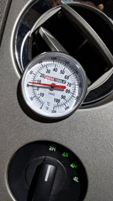

Thank you very much just today I made a test with my cousin Explorer 2008 Limited also it's black on black there was really a huge different between his car and mine I will dig more with one guy his car is GCC spec maybe my car designed for Canada spec because of that any way I will not conclude anything right now but next step is cleaning the radiator and change the coolant after that I will compare it with Expedition with GCC spec
There is one more point is it possible that blind door actuator will create such thing .
I will first clean the radiator then I will see what is next .

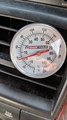

Expedition in the shade and open area
img_20190614_151511-jpg.30544

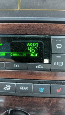

atmospheric temp reading on Expedition
img_20190614_145910-jpg.30543

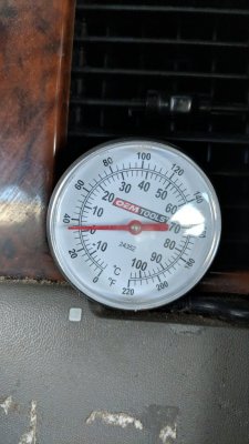

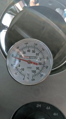

Explorer in the shade and open area also it's black on black
img_20190614_155422-jpg.30545

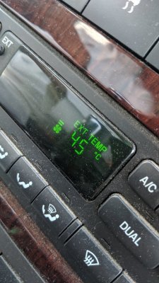

atmospheric temperate reading at explorer
mvimg_20190614_154944-jpg.30546
Both cars was at same location and at same time while taking the readings
