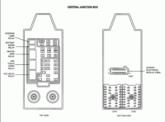

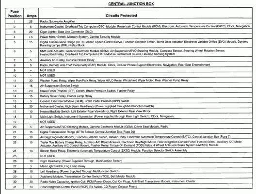

Interior lights diagram...
Running board can be disabled by fuse 15. They're not really useful.
Lights are controlled by GEM which controls 2 relays.
There are relays, and the diagram shows a main light switch that cuts the ground on the interior lamp relay.
Ford Explorer:
It turns out it's the same diagram, and same color codes for wires I looked at.
=> "I looked at the wiring diagrams, and you can install a toggle switch inline off the LT GRN/ORG coming from the battery saver relay."
=> "The thumb wheel switch controls the interior lights. Push it up all the way and they stay on forever, and pushed down all the way, they all turn off no matter what."
=> Diagram posted shows door ajar switch are fed to GEM, which is connected to the battery saver (purple/orange) and interior light (light green/orange) relays, likely grounding them. It's a better diagram than the one above, it has the door ajar switches shown.
My take is disable the interior light relay, (black/light blue) and not the battery saver relay. That means you can still use the map lights manually but I think the door ajar would not trigger turning on all the lights.
By putting a switch there it's like closing the doors with that switch.
