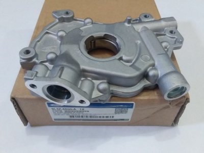

Got a few quotes this morning. Ford dealer said they don't really crack open the 5.4's anymore. That was interesting. Another guy said they don't work on them. Third shop I found has a great reputation, and quoted me $2500 to do the tensioners and the cam phasers all in one shot. Makes sense.
At 170k miles...I'm torn on what to do. Either run it til it dies, or do the work and get another 100k out of it. The rest of the truck is in great shape, and I recently did all 4 corners brakes, tires, A/C compressor and starter. So i've already put some $ into it recently.

Avoid the Ford dealers once you are beyond warranty on most of their vehicles. All they do these days is sell new engines, they do not fix hard parts or open up engines for the most part anymore likely because the techs are not skilled or knowledgeable enough, also the liability. I’ve seen so many 5.4 3V and EcoBoost engines completely replaced on the forums for timing chain issues that are easily remedied. Dealers seem to refuse to do internal work and just want to write those $9,000 bills for engine replacements. It’s a sad time for mechanics, they can’t be mechanics anymore. Some Transmission shops have told me they no longer fix transmissions either, they just sell a rebuilt trans for any problems other than electrical.
Ahhh, that makes sense. You’re prob right...it’s too invasive and their techs prob don’t have the skills or maybe even the time. It’s easier to sell a new engine and move on.
I spose for $2500, getting both timing chain tensioner, hi flow oil pump, and the cam phasers...it’s not a bad price. Just sucks it’s so invasive.
