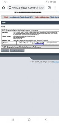

My expedition runs fine, no error error dash warnings. I was going to get my smog test done so after i started expy i plugged my reader in to see if it was in a ready state but i see a P260f error on it. Have 147k on her and shes running normal an smooth. Any ideas? I dont think she'll pass with this code showing.

You will not pass with that code. Sounds like a pcm update may be your best shot to start.

Fred, it could be as simple as your gas cap, or as complex as replacing the gas tank. Are you going to troubleshoot this vehicle, or have a shop/dealer do it for you?
