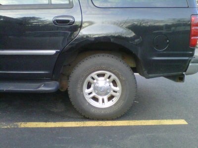

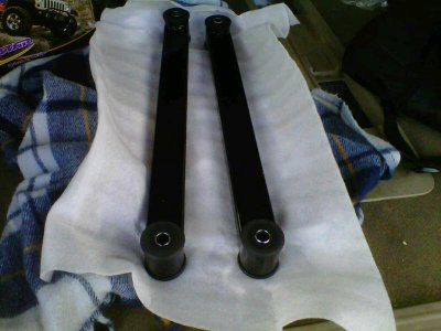

Having my lowers replaced today, and while it is in having some Daystar coil spacers installed. Bought my lowers from expysource, which we all know are PMT's. the pic of the expy is the "before" pic

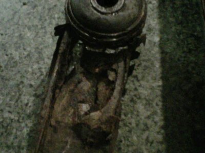

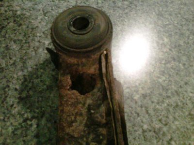

Glad i caught it before they snapped..Inspect your lowers ASAP!!!

Nasty looking.... way worse than mine I think. I will post some pics when I get mine off.

holy cow! i live super close to the beach and mine rnt even that bad. once i get some money im gonna have my buddy make some for me.

Once the coating flakes off the New England winter road treatment destroys these things. My uppers are brutal too, and the track bar. I need to get those done soon..also i have tons of other rust starting on the wheel wells, bottom of doors, and various other nooks and crannies.
