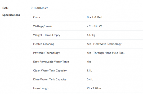

I plan to drive the following Bissell model thru this inverter with the power specs as give below :

I would get a small generator with at least 1200 watt output as the motor of the cleaner will have a surge current that well exceeds 400 watts.

I would concur with the generator idea. I believe Honda have a 1000w quiet one, but not cheap.
However, harbor freight have some inverters - I’d get a 1000w one to drive a motor (don’t need a pure sine wave one for that). Not a bad price, so may be worth a try (I’ve been tempted, but don’t have a use for it yet). The disadvantage of the inverter is battery strain and drain. The expy has a large battery, which helps.
