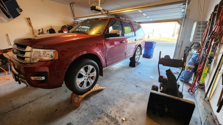

Ok, first I found I have to remove the diaper. Had to put on ramps, remove bolts on one side of the diaper and let it hang down. Checked the dip stick on a hot transmission and the fluid is low. I found out you have to jiggle the dip stick to make sure it drops all the way in for an accurate reading. I have to get some ATF and report back to see if it fixes the problem.
