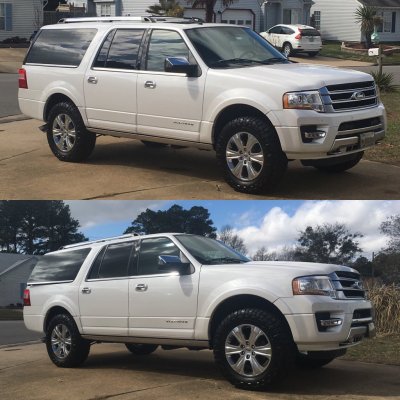

Readylift 3/2. Do a search because there are plenty of threads we’ve posted in regards to lifts. Here’s my 2016 which you’ll see in every other thread about lifts. Readylift 3/2 over 35/11.50/20F0766256-1F9B-4558-8368-476E7299C07F.jpeg

Readylift 3/2. Do a search because there are plenty of threads we’ve posted in regards to lifts. Here’s my 2016 which you’ll see in every other thread about lifts. Readylift 3/2 over 35/11.50/20View attachment 24403
Nice ride!
I HATE how short mine is. It's like I'm driving a car. At this height the running boards are useless. I'l have to read up on the height laws in Massachusetts. I know we have some dumb law regarding how high it can be raised.
