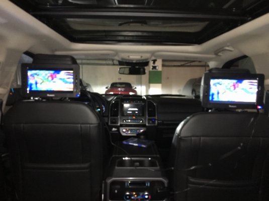

I went this route. It works great for our purposes (our 4 year old and 18 month old love them) and they were $150.
https://www.amazon.com/gp/product/B073S283N7/ref=oh_aui_detailpage_o09_s00?ie=UTF8&psc=1
Here they are...but forgive the AWFUL picture that looks like it was taken on a potato.
I hid the wires a bit, that was just a real quick "do they work?" install the day they showed up. In any case, they only go up for road trips so I don't work too hard to hide the wires.

how
How do you pipe the audio into Sync?

how
I bought a $10 fm modulator off amazon and I just plug it into the headphone jack on the TVs and tune the radio to that station. It’s not fancy, but man it works and I don’t have to worry about lag or the sound getting out of sync or anything. Sometimes the old technology works better than the new stuff.
