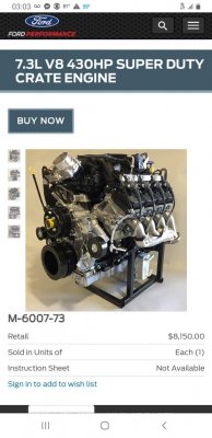

Whelp! the CPPS has become prevelant on our 09' what used to be a bucket of bolts in a washing machine when letting off the juice while backing up an incline is now happening while pulling into my driveway. I had the oil changed last week and noticed they OF'd it and am going to see if having proper oil level has anyhting to do with it. I have tried to talk the nagivator into a new vehicle to no avail since we have had so many memorable adventures in this one. We are now contemplating whether to redo the top end components and suspension/steering refreshening or a complete crate motor swap now and suspension later. Can you guys weigh in on which one is more ideal? Which is better unmating the drivetrain or rocket surgery. How far should we go if its the latter?
