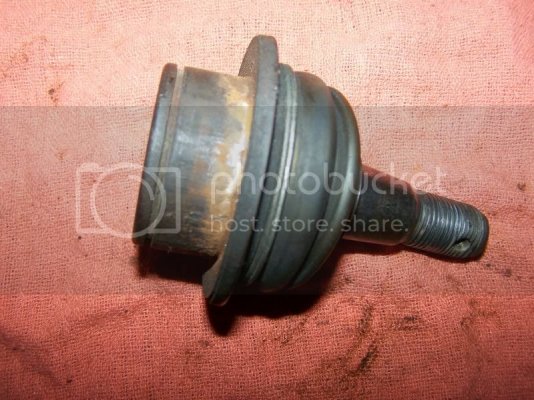

This ball joint came off the lower arm of my 2wd 7.5 inch fabtech lifted expy. It apparently is not a stock ford piece, a fabtech piece or anything that any mechanic, offroad suspension installer or auto parts dealer can recognize. I can't replace it with anything other than this piece or the offset causes the A arm to rub against the spindle and the wheel can't even turn. Please help, I am irritated beyond belief.

the picture is hard to say but it looks like the upper ball joint from a ford application dana 50
