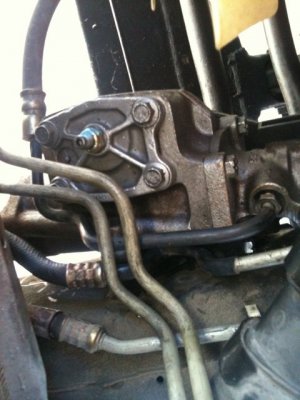

PS hoses image
I checked the hoses and attached a picture. They seem to go where they are supposed to. Some one else said I had the pitman arm 180 off, but it again was installed as it was taken off. The arm points to the driver and attaches to the steering linkage behind the steering box. Also, didn't touch the PS pump.

If you were to hook the hoses up wrong then nothing would happen as the pump is directional in flow. But if the pitman arm is 180 degrees out on reinstallation, then you would be opposite direction steering. But on these applications, that would have to be impossible with the steering linkage is on the inside of the crossmember and would not allow you to do a 180 degree out in the wrong direction. I would be looking to see if the pump you have is deffective or wrong pump. And by the way, the hoses are correct based on your after pic of location.

I agree, has to be the wrong box. lying there staring at it for a bit, can't see what else it could be. I agree with the PS, since it also does it with the truck not running. Same with the pitman arm, there is nothing to attach to if it is 180 off. Thanks.
