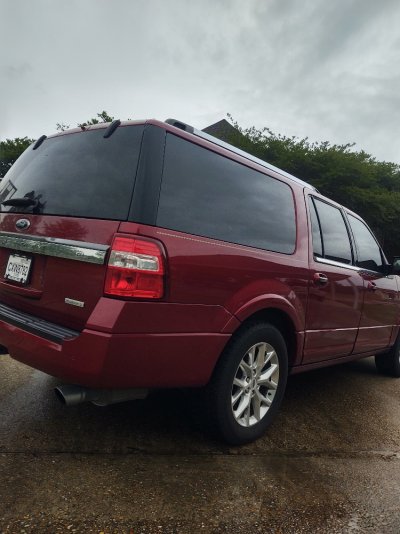

Just bought a 2015 limited EL. Got a leak in the rear headliner area. The middle trim panel is broken, so I assume they knew about this. Thinking maybe roof rack leak.
Question: How do I remove the cap on the rear of the roof rack and seal the bolts?

I just remove my rails to ha e them powder coat, the ends caps pops off, pull straight up, be careful not to break the tab holding it, two T-bolts, all four corner, the middle brackets slide it toward the front of expy, rail comes off
