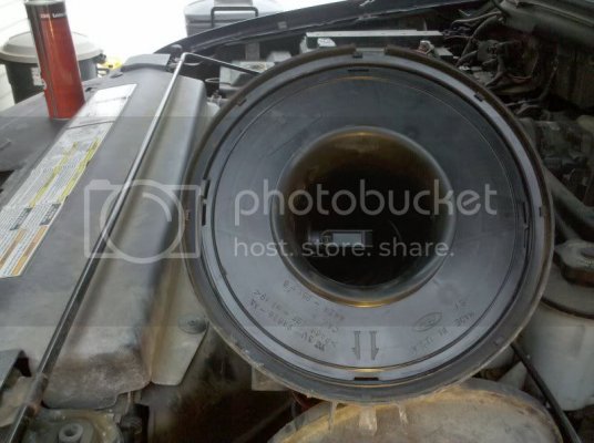

I had same codes show up few months ago. Reading some posts I looked for some vacuum leaks and in doing that I found a lot of gunk in one of the hoses on the left side of the engine as shown in pics. Cleaned that up and it helped a lot, but not completely smooth as it used to be. By the way why all that gunk formed in there? is the engine dying or something? it feels strong now. Any help will be greately appreciated.
Johel.
