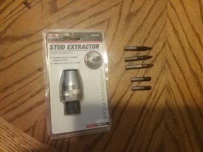

I just recently removed 5 bad studs, 2 that was broken, using this stud extractor.
Just to make sure they came out, I put a little heat on the head exhaust port near the studs.
I replaced the studs with stainless steel studs and nuts, no more rotted studs and nuts.
