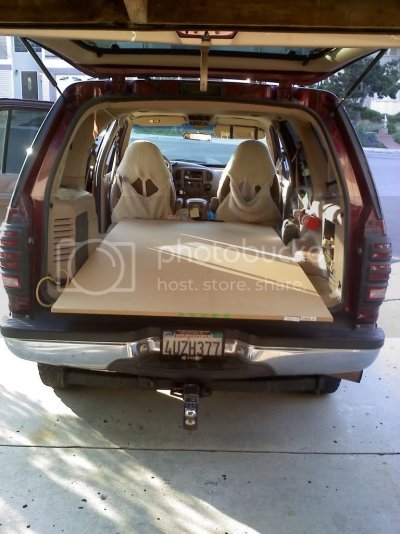

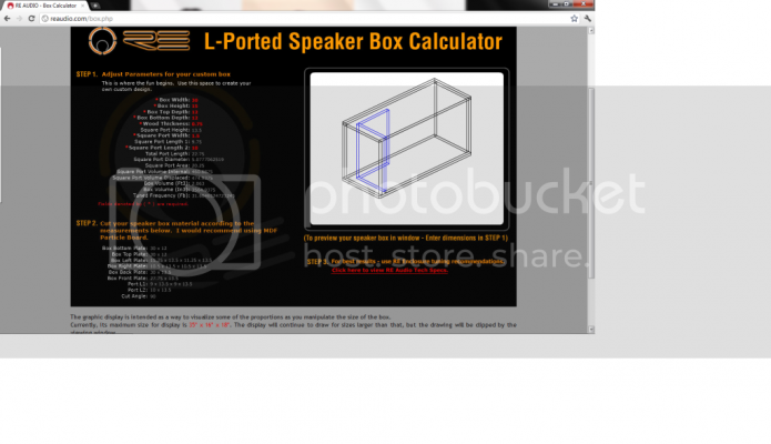

so i was getting tired of my ghetto ported box so i went and made my own. so i went online and used a sub box calculator. http://reaudio.com/box.php it works real well and you can make your box into any size shape and tune you want. heres what i came up with. speakerbox.png 2cbft at 31hz. so i went out and bought some 3/4" MDF. bigwood.jpg it didnt fit. it stuck out like 4". so i closed the back and used a bungie cord to keep it down. (i learned my exhaust is super loud when im on the gas. you can really hear it with the back open.)

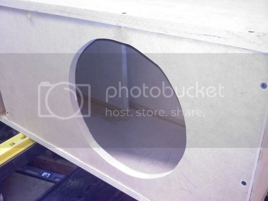

well after a few days of drilling and counter sinking the holes it came down to glueing and screwing. holecut.jpg holeport.jpg
for some stupid reason the port moved about 1/4-1/2 inch for who knows what reason. so now the front piece is all off on the port side. its not a big deal. im gonna get some bondo eventually and fill in the space. and all the screw holes.

i have 2 of those now in a sealed box...i want to go vented...what freq is it tuned at? what cu ft did you go with? i know the range is 1.75-2.25 per sub for 12's
Dexter
Sep 27, 2011
169
Houma, LA
I used to have 2 kicker CVR 12's in a ported box tuned around 34 Hz and it sounded good. And for future reference: The RE Box calculator is a bit inaccurate, but if you're not looking for EXACT tuning, it does the trick!
FREEWAY, all of those questions you asked are answered in the first picture.

its 31hz. a little low. but its all good. and i know its not 100% accurate. but if i wanted it perfect i would have gone to a professional. and no this sub isnt going to stay. either an RE Sex or a power acoustic ****.
