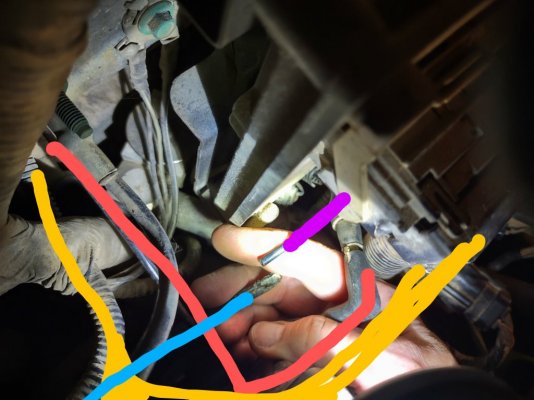

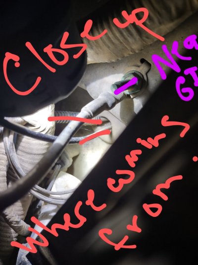

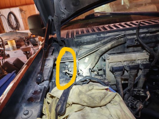

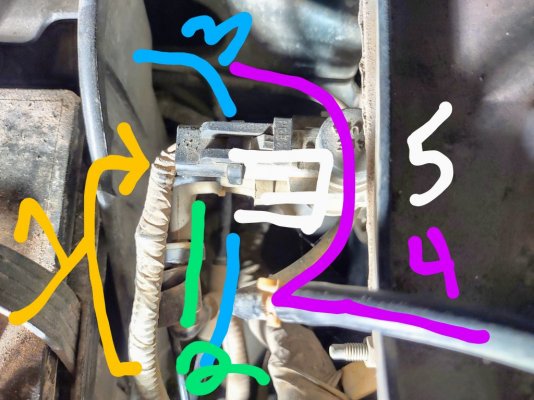

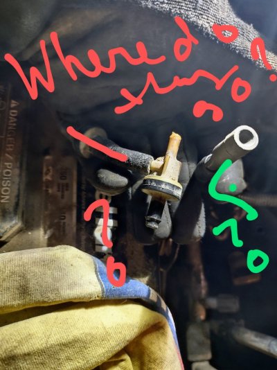

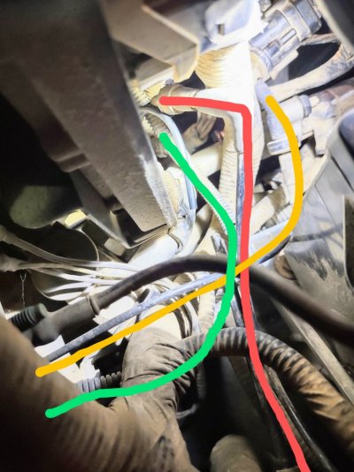

After changing out all the other hoses, I have came across several broken vacuum lines in that area. Can anyone tell or show me which ones go to which? 1st pic: yellow 1 - electrical hookup to solenoid.Green 2- 1st vacuum lines. That has a T drop to the Blue 3- hard vacuum line that goes behind battery. Purple 4- water tubing to windshield visors. White 5 solenoid on wall has the shape of an "E".

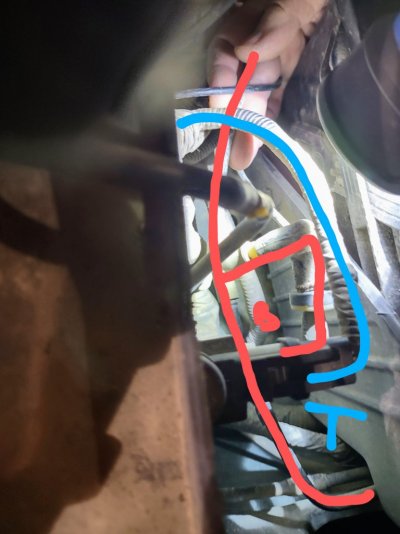

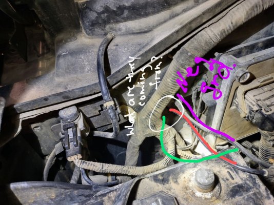

More pics
