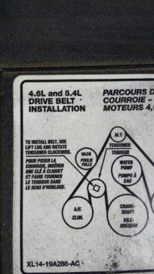

The reason I ask is I am looking at the auto zone app and trying to figure out what one to select for my vehicle. This is what the sticker says under the hood
Sent from my SM-N900P using Tapatalk
