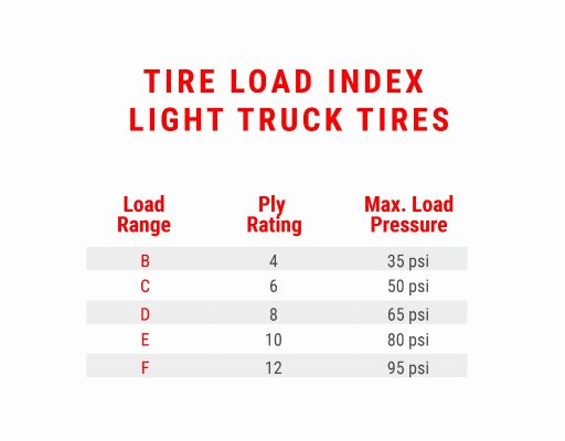

The load index is the actual load bearing capacity in lbs and there's a chart for that. The letters actually correspond to peak pressure. Load C is ~50, D is 65, and E is 80 psi. Since no on is checking really checking a load chart for a "116" tire, it's easier (at least, for me) to signify the load bearing ability using the letter, even though it really refers to the max pressure.
"Better" is not quite accurate for higher load tires. It's more a question of suitability for the intended purpose and tradeoffs. I wanted more stiffness for towing and greater puncture resistance since I dreaded getting a flat while towing and had numerous repeated punctures from construction in the Houston area. Getting tires patched repeatedly was a PITA and I had a flat while towing, so wanted to minimize the risk of that happening again because I had eight tires to worry about. I was willing to sacrifice some ride quality, mpg, and acceleration. The "D" tires looked like they had more aggressive, off-road oriented treads, so I went with a three-peak rated "E" that I felt might align more closely with my purpose. I'm satisfied with the tradeoff, but YMMV. Images below to illustrate.
