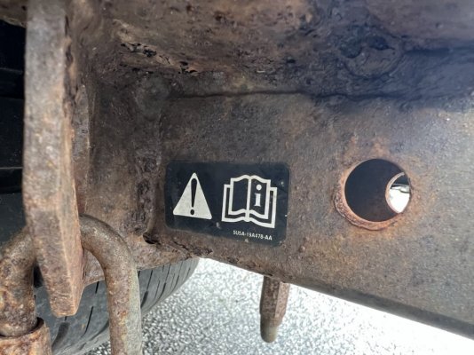

thanks! one more question. The body itself has some rust damage, but the chassis itself looks like it's ok. I did just get this picture so not sure how bad this rust is around the trailer hitch. thoughts? should i walk away?

Hard to say from that image. I'd have a mechanic look at it.
