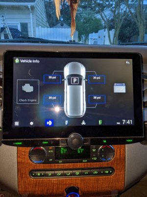

If you get an OBDII reader and any of a multitude of free apps like Torque, you can read individual sensors. I also have a 2009 and can verify it works. It also shows on my new Kenwood stereo/monitor screen.

If you can get to a tire shop they can read each sensor and it can tell you which one may be having a problem. As the battery gets low it can start having weird issues. The torque app definitely works as well - get a bluetooth OBD2 reader off Amazon or eBay.

Thanks guys, as I had to tell the system where each sensor was and it then tells me front left tyre low, etc, I assumed the system would tell me which sensor was not working!! My bad, I will visit a tyre shop and see if they can tell me. I have an odb11 reader, but it says there are no codes!!
