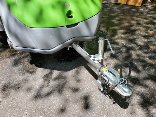

I'd like to set up trailer assist on my new 2023 SPP. My concern is that my trailer has a tubular tongue with no flat surface on top. (see picture).
Is there any chance the ford sticker will work if placed directly on the tube? Or would I simply be wasting a sticker? For scale, the coupler is for a 2" tow ball.
(The trailer is a SylvanSport Go if curious)

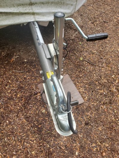

I fabricated a 2x5 plastic plate to mount the sticker flat and horizontal. Works like a charm.
