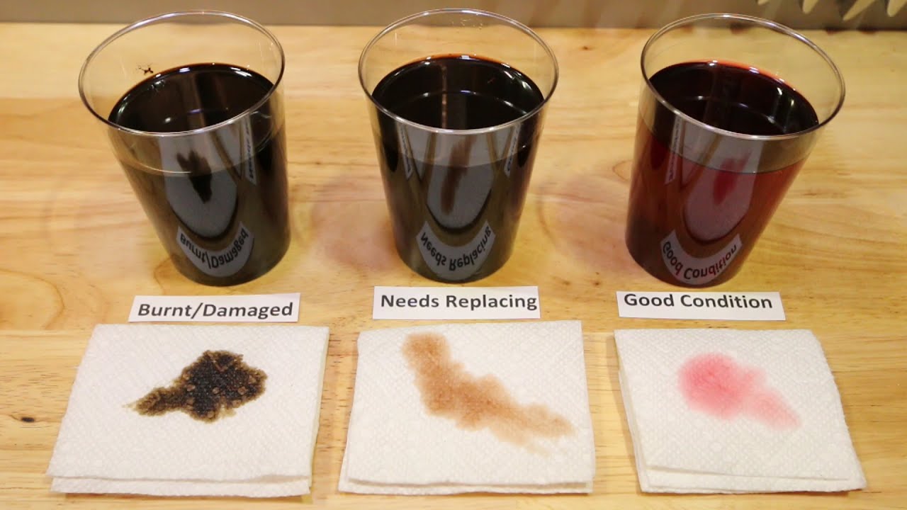

So, is that a myth or should I be concerned?
It all depends on what your transmission fluid looks like now.
Here is a video to explain,
Bottom line if your transmission fluid is dark, your transmission already needs to be rebuilt and you are riding on borrowed time.
Granted borrowed time could be years, but it also could be tomorrow that it leaves you stranded.
AnarchyOutlaw
Jul 12, 2021
Chesapeake, VA
This clip answered a lot of the questions I had about this topic. I've had it happen where I bought a used car with high mileage and changed the transmission filter and fluid, only to have the transmission completely crap out right afterward. Now I understand why.
