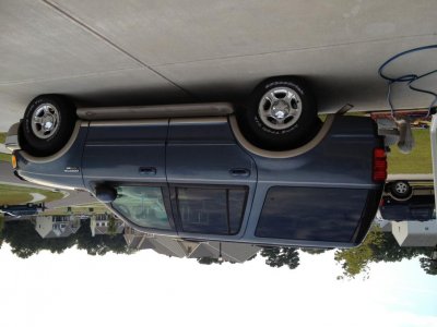

Up to about 400 miles so far, got new oil and a serp belt today. Also got a new gas cap and cleared a p1450, hopefully it's just the cap, if not ill investigate the vents/canister.
Running like a champ. Over the next month or so I'll do the hoses, trans fluid, rear end, coolant, break fluid changes. That's about all the ford dealer recommended today, otherwise seems solid.

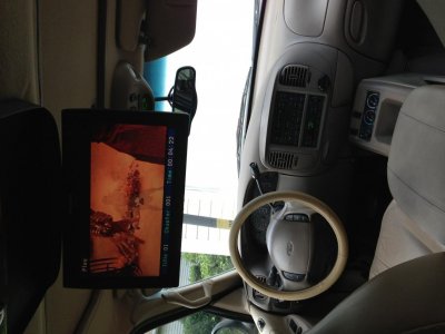

I have an annoying rattle in the roof between sunroof and DVD player that I need to solve. Sunroof isn't working so I might try shoving some sponges in that area, it drives crazy.
M1757
May 6, 2013
Philadelphia, Pa
I recently purchased my 2001 Expy EB with 106,000 from original owner for 3,000 he was asking 3,600 and I would have given him 3,600 but he said yes immediately to 3,00 cash. Anyway, as far as the rattle coming from your moonroof, thats the only problem my truck had and from the good folks on here it was obvious that the metal drip tray on the rear part of the moonroof falls off due to the two way-to-small screws holding it on. If you just go and re-install it in the factory screw holes it's gonna come out again in 100 miles. There is a flat spot, if you go towards the center of the truck, about an inch in. I drilled a hole in the drip tray and ran the screw through...it's never come loose since. You will have to remove the moonroof to do this, it's really pretty easy, just make sure to take a pencil and trace around the four screws that hold the moonroof in place on the inside of the truck. I re-installed mine three times in two weeks till I decided to move the screws that some engineer at 130,000 a year couldn't figure out. P.S...that rattle is the most GD annoying sound. Good luck.
