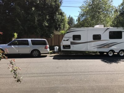

Hi there - new to the forums, which I turned to to get some help with towing info.
We have a 2016 Expy EL XLT 4wd and just purchased a Keystone 31ft Bunkhouse. I am using an Equalizer hitch but on its first run was sagging a lot in back. I have adjusted the hitch (which is very noisy) and while it helped, I am trying to learn more from others who have be doing this for a while.
I see others; setups appearing very level - was wondering what mods or adjustments others have done (especially with the EQ hitch) or what hitch others were using to tow.

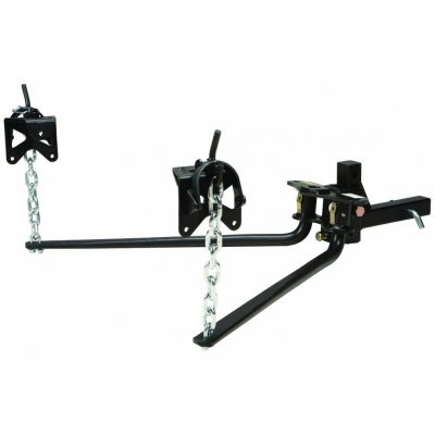

Hey, I'm new here as well. I have a 2015 EL that we use for towing a 27' Bunkhouse. I found that when I hook up the bars on the hitch, it helps to get as many links down the chain as possible before you put any weight from the trailer on the hitch. That seems to help keep the trailer level and actually tows better.

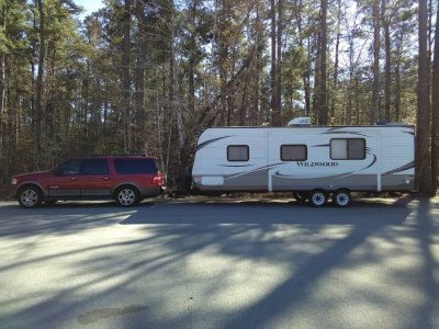

I tow a 29' TT with slide at 5900lbs empty with my 2007 EL and don't seem to have issues. I use the WD hitch from Harbor Freight and I agree...the more chain links you get in the better. When I went from 3 to 4 links it made a world of difference. You also have to set up the height on your hitch at the proper position.camper.jpg

I have a 2014 EL with the HD tow package. I tow an Apex 30ft bunkhouse. Dry weight is ~5000lb, loaded weight ~6000lb with ~630lb tongue weight. I use a four point Equalizer. There are actually two hitches called Equalizer. The E2 only has pivot points at the bars on the camper tongue, this is sold by Fastway. The only adjustment for this is the height of the L brackets.
The "true" Equalizer has pivots at the camper tongue and the hitch head.
I have the later type. There are different weight classifications for this type as well. This hitch has adjustments at the camper tongue (height of the L bracket) and at the hitch head (angle of the ball and bar brackets) that affect how the load is distributed. The L brackets are adjusted by bolt holes, the hitch head is adjusted by adding or removing washers and then torquing the mounting bolts.
If you haven't done so I would suggest reading through the installation manuals and setting up the hitch according to the manual. It took a few adjustments to get the measurement on my front wheels to be where it needed to, but well worth the time spent.
