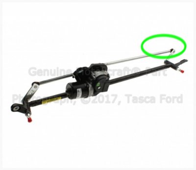

Anyone have any experience with failures in the front wiper transmission?
My passenger wiper isn't moving. 09 LTD MAX
The linkage (silver) coming from the motor is still moving. but the wiper isn't moving and I can move the wiper freely through the motion by hand without issue.
See image below. Does the linkage ever break at the wiper arm/pin? If so is this repairable? I can't get the plastic cowl cover off to see as my wiper is stuck on the shaft.

Happened to me. You can pull the cowl plastics and get creative with some zip ties for a temporary fix but you'll be back in there again in 6 months.
You'll end up breaking clips so go ahead order these ahead of time: https://www.amazon.com/gp/product/B006OCTUG8/
The real fix is to order and install the whole wiper assembly. Thankfully it's a relatively cheap part.
https://www.amazon.com/gp/product/B0080B3Z44/
As for installation, it's seriously some voodoo. The engineering that went into making sure it can be slid into place is beyond me, but it does somehow fit. To say it's fiddly is an understatement. Pay very close attention to the orientation of the existing assembly when you manage to remove it because the new one has to go in the same way. I didn't, and the 20 minute job took me 2 hours of twisting and turning and pushing and cursing.
Seriously, it's only a 20 minute job if you can quickly figure out how the assembly slides into the cowl. It comes out and goes in from the driver's side of the truck.
Oh, and to answer your actual question, it's not a serviceable piece. It's molded rubber that wears out and causes the linkage to disconnect. It should be serviceable, but it's not.

What you mean to say is "you'll need to scour your junk drawer for parts that will make it work"
It's built kinda weird. Ball-and-socket type of joint, where the socket is a rubber cup that wears out. Rubber-injected in this case makes no sense. Had they used PTFE like in a spherical uniball it would have held up beyond the life of the truck.
One permanent-ish solution would be to drill a hole through the ball and the cup that it goes into and use a small bolt with a nylock to hold it together while still allowing some play as it twists.
A better option would be to cut the end off the socket piece, weld (or cut threads) a rod end on there, drill out the ball end, and assemble with a bolt.
Regardless, it's a PITA, and all of those options are made infinitely more difficult if the repair is attempted with the assembly still in the truck. Also, that fix is x2 because the other fitting is sure to fail soon.
I try to factor in the value of my time where many of these repairs are concerned, and $120 + an hour or two is worth it to me for a fix that should get me through another 150k miles.

thanks guys. I bought the new transmission (and motor assembly). Good tip on the clips also as I broke every one of those damn things.
One tip I found on a youtube video was to remove the hood shocks and stand the hood straight up or carefully lay it back on the windshield. This allows the whole transmission to slide right out the drivers side. Very quick exchange if to move the hood out of the way.

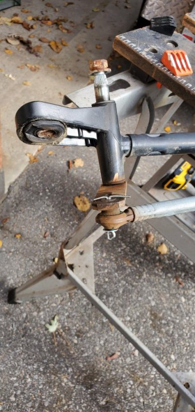

Just had my passenger side fail today. I thought I'd try to repair rather than replace the existing assembly. Thought I'd share and maybe others can improve on my janky method! This approach may not be advisable if it were on the drivers side but on the passenger side where it isn't as critical, I figured I just needed something to help hold the ball-joint together. So I drilled a small hole through the centre of the ball and put a cotter pin through it with a washer on the head of it. There is lots of clearance around the linkage when it is operating so if the pin fails, or you wanted a more robust connection you could drill it out larger and use a bolt and locking nut.
I found this video helpful: How To Replace 07-14 Ford Expedition Windshield Wiper Transmission
